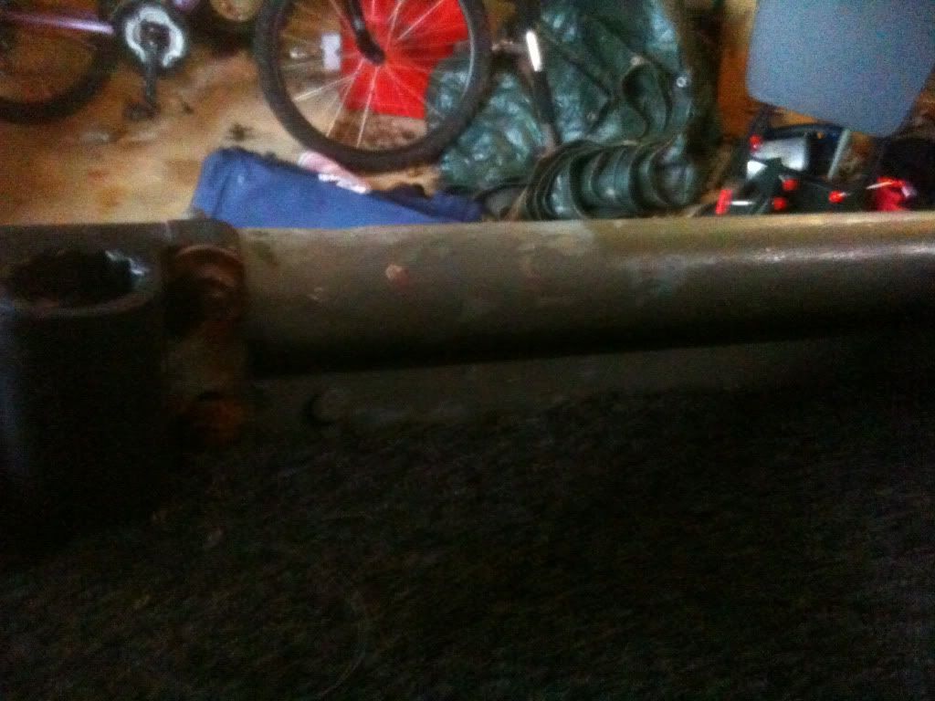

A picture of the front of your boat would help, but if you are saying you have a flat surface with a one inch lip around the edge, you will have no problems. All you need is to cut out pieces of a shim material, plastic would be best. You could use puck board, or those cheap white plastic cutting boards they sell at dollar stores. Just go at least a 1/4 inch more than you need so 1&1/4 inches. You will have to buy longer stainless steel bolts than come in the kit.

Installing a foot control troller on the stern is not only a bad idea, it defeats the purpose of having a trolling motor in the first place. Trollers are far more efficient pulling a boat rather pushing. Boat control is simply far better, especially when the wind picks up. As for the bow issue, it really isn't an issue. Use a little creativity to fashion a spacer to level the plate and go fishing.

Well, those are very nice pictures -- all of them being of the same thing and so close that I certainly can't make anything from them. It appears though that all you need to do is make a spacer so the plate clears the lip.
