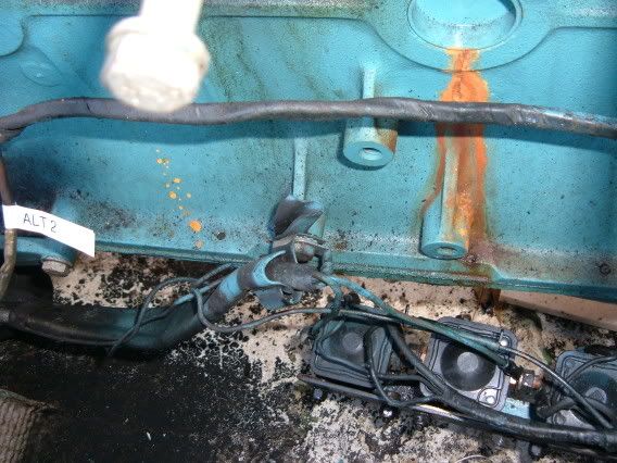

Is the crack similar to this one? This picture was taken as I was removing my engine due to the crack in the picture... Emulsified oil boiled out of it, the breather, into the carb, etc, etc, etc...
Granted, it is a different engine, but on a boat, I was not going to consider "fixing" a crack. I know it's done, but not on my boat!
