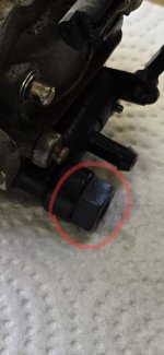

Hi,
I have a 1991 3hp, there appears to be 2 fuel nipples. Part 30 and part 31. Which one is the fuel inlet? I have the fuel line hooked up to the smaller nipple, part 30. But when I do I lose fuel through the missing part 31.
Why are there 2 nipples? Where should the fuel line go?

I feel like I'm my engine 30 is the fuel inlet and 31 isn't a nipple it's a drain plug. Could that be correct? Does anyone know the size and thread of the drain plug? I need to plug this asap.
Long story short I came back from a dinner to find my dinghy with the fuel line disconnected and this piece missing. Someone must have sabotaged it.

It's an internal tank. Does anyone know the size of bolt I need to plug this hole?
38,411

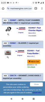

#32 is a fuel pumping bladder.----#31 hooks up to crankcase air PRESSURE pulses.-----I would have to find a carburetor to check the threads.

Looks like I had the wrong year, I looked at 1990 and it matches what I have which is just a plug.
I need to use the motor today, I'm guessing I can just use a 1/2" bolt to plug it?

saltchuckmatt
Jul 19, 2019
2,811
I think your confused. 30 is a roll pin. The spot or Barb next to it is part of the carb, Your missing 31 and possibly 32 and a rubber hose?
Or yes you have a 90 and your good I guess.
Not sure how it gets it pulse though. Look for a barb fitting not being used off the block.
