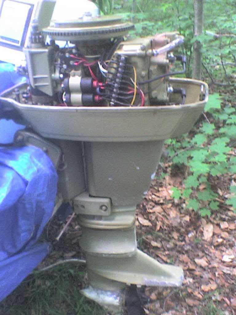

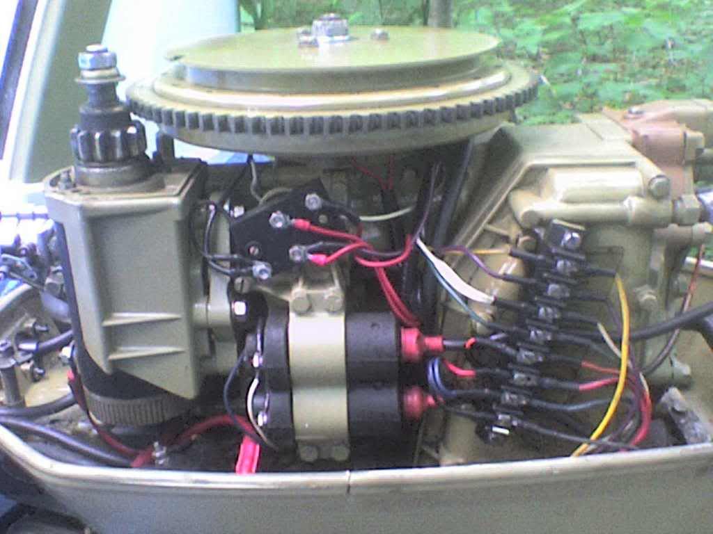

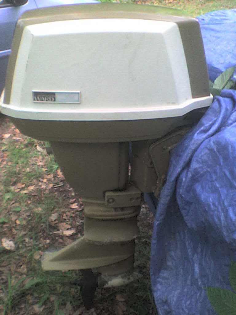

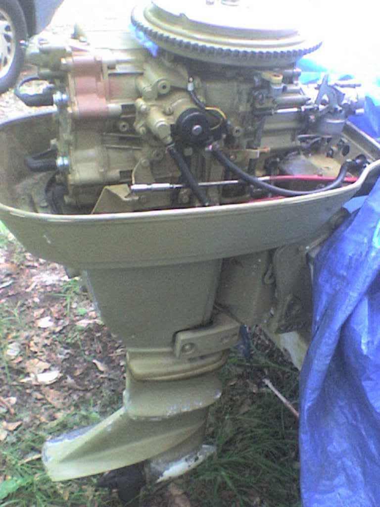

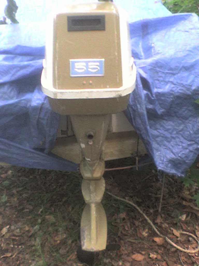

Hey guys, again a year crisis, have a 55 hp Mont. Ward pics below

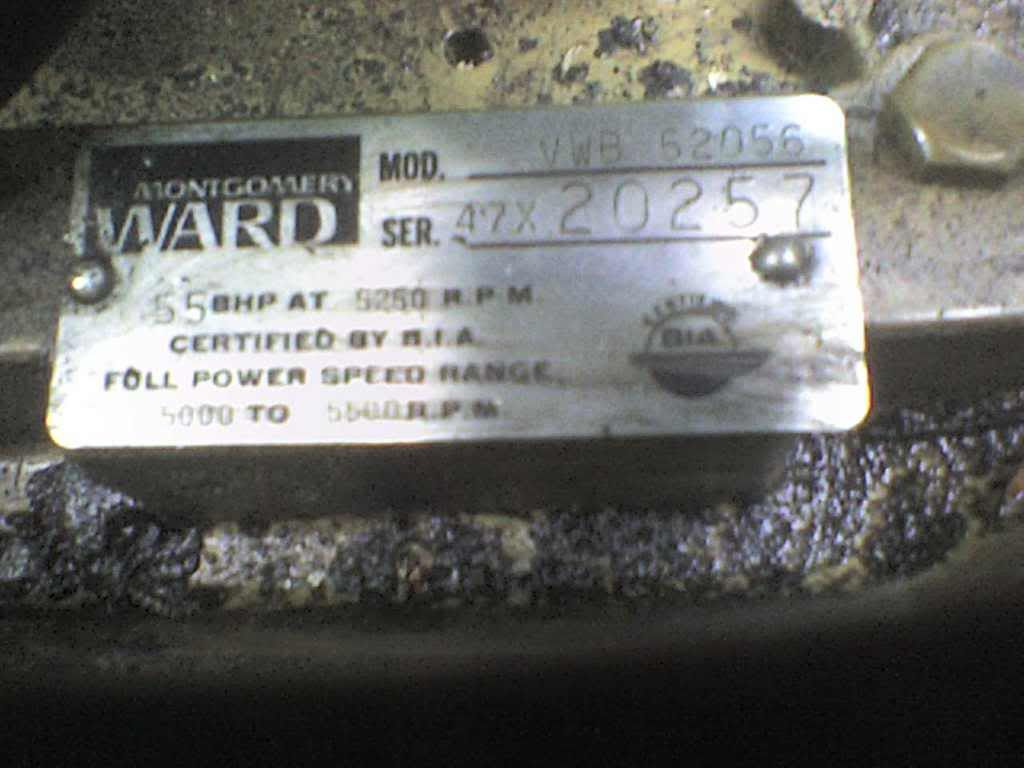

http://i201.photobucket.com/albums/aa121/mrsistr/DSC00253.jpg <Model Tag
http://i201.photobucket.com/albums/aa121/mrsistr/DSC00254.jpg
http://i201.photobucket.com/albums/aa121/mrsistr/DSC00255.jpg
http://i201.photobucket.com/albums/aa121/mrsistr/DSC00256.jpg
Mod: VWB 52056
Ser: 47x 20257
I Also seem to have some major problems with it, when i try starting it, nothing, when i take of the spark plugs and crank a bit then replace them it backfire when i try again, but after tat back to norm, I fear i have lost the compression, but i donno, When i bought it the guy said it was running fine and the coils went, but after he replaced, never run again, they mit have messed the wiring, but not sure really. Any ideas??? Well thanks for the help.

You need to get yourself a service manual.You may find one at the library.Your motor is a 77 built by Chrysler.I believe there are three possible ignition systems for your motor.
This isn't going to be good news.Indiscrimnate trouble shooting of the ignition on your motor can cause damage to the components.I believe some components are no longer available.Plug wires must always be able to discharge to ground.The Chrysler pros should be along with more info.

As for compression question, that is easy to determine with a comp gage.
Fortunatly, yours does not have CD ignition so it is pretty simple.
So, do you have spark at the plugs/wires? It should jump at least a 1/4" gap.
If you do have a 1/4" spark, backfiring could indicate the spark is at the wrong time. Thsi can be caused by the spark plug wires swapped to the wrong plugs. OR by the primary leads to the coils swapped to the wrong coil. OR by improper tightening of the flywheel nut, causing the key to shear putting the flywheel in the wrong relation to the shaft.
These ideas should keep you busy for awhile...
