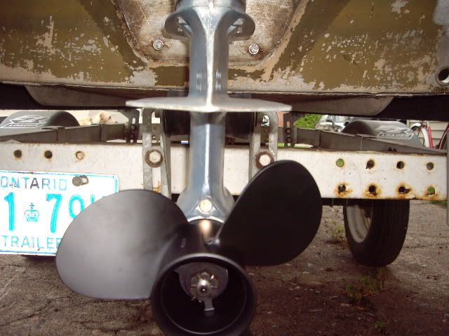

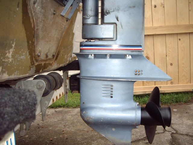

I had to rebuild my transom on my 14'r Sea Nymph 1973. I was reading on here and other places that the fine (plate) pretty much where the lower end meets the top end should be level with bottom of boat for best results. Anyways I rebuilt the transom to that requirement and boat seems to gurgle when doing a turn even at a 10 degree turn. Also there was a website on here that calculated the weight of boat model and weight in the boat, prop pitch and motor which said it should do 23-25mph with my 1980 Evinrude 15hp 9.5x10 prop. On GPS I only get 27km an hour wide open and had her tuned up at the boat dealership 2 weeks ago.
What Im wondering is it cause Im either to high or to low on the transom?? Here are some pictures of how she sits.

Mb, I am not exactly sure what you are talking about when you say gurgle. If the motor is too high for the prop you will experience ventilation (RPM go up and you can feel the prop slipping and the motor rising in speed). But from looking at your setup on the boat it appears you are still too low on the transom, although it is hard to tell from pictures. When the lower unit sits tool low in the water you experience a lot of drag which slows the boat down, and limits the RPM.

when I look from the side it looks to be even with the bottom keel. I even rebuilt transom 2" higher then the transom my grandfather had on there. Have no recolection of how it ran at that height since that was 15 years ago. All I know is it sounds like its running smooth except when I turn it feels like it is starting to slip and makes more noise. I have no idea what the RPMs are but from reading lots of threads on 14' boats with 9.9s hitting 25mph it makes me wonder WTF is wrong with my 15hp when it can only hit 15mph
Maybe the throttle isn't twisting fully open for some reason?? It there a sight on the web thats shows how to check for this for a 1980 15hp Evinrude??
