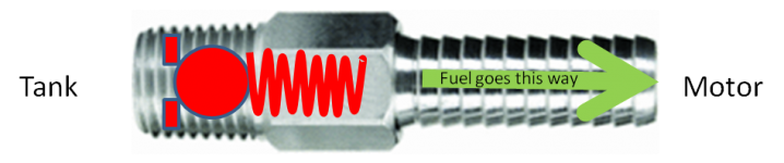

Boat probably has a mai tank and not a portable type. Remove the antisiphone valve from the tank. The valve will have the rubber fuel line attached. It has a spring and ball inside which can get clogged up

I really appreciate you getting back to me on this as that will be my next step to try. Everything that you’re saying is true but I have replaced the fuel pumps the bulb lines motor runs fine and thought about that in the tank and I’m not familiar with that but I did take the top of the tank off and has a little lever and a rubber grommet on the bottom and I’m trying to figure out how to get that out or replace it or something. Seems like that’s a logical step I just need to do a little research but I really appreciate that

I was walking and not making sense. I have access to the tank in the middle of the boat. I am not sure where the anti siphoning spring is but I do have access to the tank in the middle with an access door. I will do some more research but it sounds like you might be on the right track. It might not do it for an hour or 2 so the five gallon might not work. I will try the first thing you mentioned
