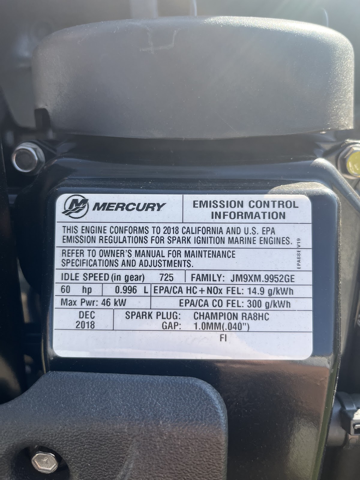

This motor has about 10 hours of run time on it.
Last time I used it was in saltwater and before storing it, I hooked it up to a hose and ran it for about 15 minutes.
Boat sat for about 2 years before I found the time to use it again. Before taking it to the lake, I dumped as much fuel out of the tank as I could and filled it completely with fresh gasoline. It still had some old gas in it, but only about 1/20th of the tank. I also added what I had left of a little bit of the fuel additive that the motor manual said to use. I hooked the motor up to a water hose and ran it for about 10 minutes. It didn’t sound great, but it ran.
Launched my boat, and it cranked over and roughly ran for about 2 minutes before dying. I cranked it again and it ran for about 10 seconds before dying. Cranked again and it ran for 5 seconds before dying. It eventually stopped cranking completely. Every 10 cranks or so it would try to turn over and go for a couple of seconds before dying.
I cleaned out the fuel filter and emptied the bulb, and was able to pump more fuel into the bulb through the hose, so I know that’s working. I checked the oil levels and it has oil. Visually looking at the motor, it looks brand new. Nothing is damaged.
I would like to learn how to work on this myself, but am stumped on what next steps to take to try to get it running again.
Do y’all have any advice for me?
Mercury Fourstroke 60 hp
