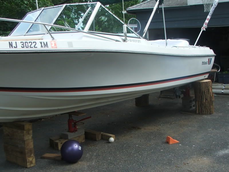

Yup seems like its been well covered. Biggeset problem for me was finding enough crap lying around to block up the back.... Then I thought about a friend of mine that cuts firewood. Asked him to cut me two big ol honkin logs to the exact length I needed and they worked great

nice logs...;)
I used old tires before and they worked well!
