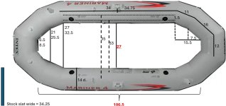

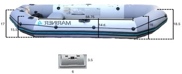

Start with some baselines. Measurements are in inches (standard). I couldn't find a nice low side-view of the older model Mariner 4, and yes image is flipped to match direction. There's too much flex and I did not have inflate it 100% so use with caution. I did NOT inflate the keel, which would add some height (1-2"?) when considering transom mount placement if you choose to go with long or short shaft outboard.

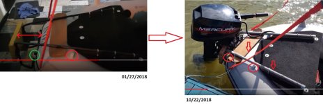

Motor Mount.
Credit to this person.
https://www.youtube.com/@adrianodomingos8185
Seems he evolved his setup. I think the additional space between the motor and back of the boat in his original design was not optimal b/c it creates too much leverage (similar design to the Intext motor kit). I envision Archimedes principles on leverage applying here where less is more, made worst against a soft surface. He also did not use the boat's top (or rear) mounts, I think b/c the angle tracks it along the tube, which is still soft. Yes, that is a 15hp Mariner, I'm not sure I recommend that. It looks like the things shifted a little.
My initial thoughts on a DIY mount. Goal is to keep the motor as close to the boat as possible. Interesting to note the height of the rear of the boat (keel uninflated) is ~17". The Hangkai is ~18.x" from top of mount to anti cavitation plate.
