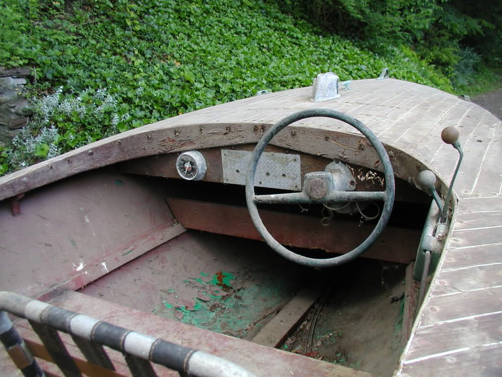

Well I finally spoke with the guy that owned the farm that I found the boat stored in the barn at. He told me that his father was the original owner and he brought it back from Florida in about 1962 to this area. He thought that his dad didn't buy it new and really didn't give me any hints about its real providence beyond the fact that it was last used in 66 and stored in the barn ever since. I asked him about any other parts that might be still in the barn and he mentioned the 1 foot wide piece of wood(center deck) that I already discovered on my last trip back to the barn.
I guess I will have to keep looking but I think that the key may be the unique decking with the cedar planking in the vertical pattern on the deck and angular on the side decks.
I have had a couple of other suggestions about maybe Dundee or Tomahawk or Thomlinson.
The search goes on. Anybody else ever seen this decking on a molded plywood boat? Note that the white lines are handpainted.
http://i688.photobucket.com/albums/vv241/tmeraw/TK Before/P1010008.jpg
