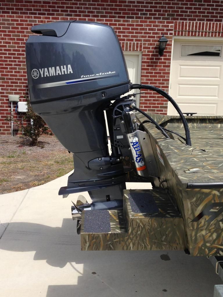

This what he has Sea except a Erude....and no the motors not too high.

Quote : Hi guys, I'm having a problem getting the mid-range rpm from my engine, I will give details. I have a 1860 center console aluma-craft all welded tunnel hull with a 90 etec.. Faz, don't read any Yam motor posted nowhere.
Skinnyrunner, can you post a neat pic of your current ETEC 90 HP motor shot sideways ?
Doesn't matter much which motor brand or model they are, all have upper and lower plates, some of them with shorter plate distance between them, other way larger. It's a matter to find the right lower leg height for best prop thrust in most water conditions. The issue is that nobody visually looks what's going on at front of lower leg which is the fastest way to dial the opt transom/lower leg height,
Playing excessively with trim settings, ear sound transom height optimization as to determine if having prop aeration or water splash issues while wild guessing with motor heights is the correct procedure to going nowhere and losing precious neat boating time.
Happy Boating

That is the type of boat he has and that how high motor sets on these......and a Yam and Etec lower unitsare also copys of each other.
