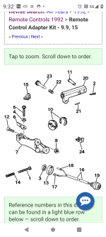

Hello I'm new to the forum, I have a 1992 Evinrude 9.9. I'm trying to get it set up as all remote, shift, throttle, start, steering. I have a couple of questions. In the remote control kit there is a screw for a throttle stop. Not sure where it and it's spring goes.

Put up a pic of the screw. Is it the screw with the pin through it?

This is the adapter kit for the 9.9 rude remote. Is it any of these parts?

#1 and 14. Instructions say screw in to threaded flange under stator plate, along with a really bad picture. I have everything from that kit except the kill switch.

look under the stator plate, should be a tab with a threaded hole in it. You have the harness off of a larger engine. you probably don't need the purple wire.

Purple wire would go to electric choke I believe so you might need to purchase the choke solenoid and linkage.
I believe that screw is so you can adjust idle before you hook up the throttle cable.
Tiller throttle adjustment must get bypassed I'm assuming. I know where that screw goes on a 25 but not sure on the 9.9
