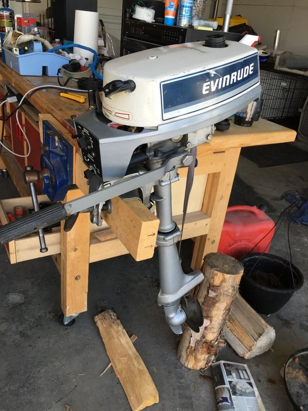

Found this on our local auction site for the price of a tank of gas. https://youtu.be/vwOCuCWZXa0
'84 model.
Compression is good.
Seems to run cool, but the gas valve leaks badly. I'll need to give it some TLC - maybe an impeller and a carb cleaning. It'll make a good emergency kicker for my tin boat.

It's an '84, my rebuild has '82 livery. Close enough, but if I wanted to complete the look I could pay almost the price of the motor for some repo decals for an '82. The answer? Nah...
I need to fix the packing nuts on the needles and the petcock the former are loose, and the latter leaks.

Well, something had to be wrong. Gearcase was full of water. Seal under pump is torn. Gears have some rust but seem to mesh and run OK, so I'll re-seal and hope for the best. Usage is expected to be minimal, so...

Re-sealed the gearcase and although pitted, the gears mesh OK and run OK too. Got a spare set of gears from a fellow in Florida that I'll keep in the event these get chewed up. Fixed the fuel petcock leak with a couple of spare O-rings from a carb kit, and rebuilt the carb - no more leaks.
Put the kicker bracket back on the boat and hung it tonight. Heading out to Kootenay Lake on Friday. Good to have a little backup instead of paddles. (Truly little in this case - 70x more power on the main thruster. I don't think I'll plane out on the 2.)
