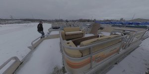

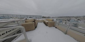

Well, after looking around for a rebuild project pontoon, I have pulled the trigger on a 1984 Sun Tracker 24 Party Barge. Considering the boat was in the 'Junkyard" I am pretty happy with its overall condition. I was originally planning on stripping it down to the bare tubes and cross members and rebuilding from there but I might get away without having to replace the decking. We will see.
I am comfortable with the mechanical, electrical, and carpentry aspects of the rebuild so this should be a fun and interesting project and a source of video content for my YouTube channel.
One thing I have not found in my drooling over online parts warehouse catalogs is an aftermarket changeroom. I have female family members who would greatly appreciate a potty and I plan on using the boat for a dive boat so was thinking a fold down changeroom would be a great addition. Problem is, so far, I have not found anyone who makes an aftermarket fold down change room. Is this not a thing for older boats or am I just not looking in the right places?
Thanks
Doug
