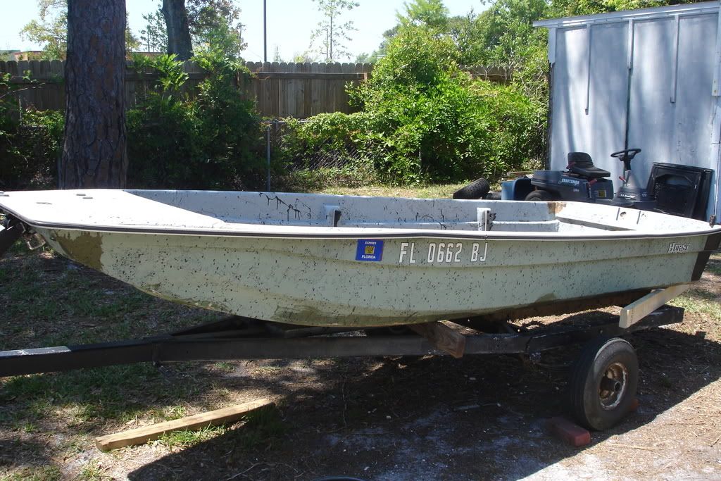

Thanks everyone for you great response!!! my boat is a 1974 hurst ???? something. i cant seem to find any info on this boat but i do know it was built in orlando fl. the boat is a true 14' and the transom is 52" wide. the sides are a about 15" top to bottom. i looked into this 30 mariner and i guess it came off a boat with stick steering. my plans are calling for a tiller steer. im not sure if you can convert. im kinda thinking a 25hp might suit my needs a little better. this boat doesnt have to screem through the water but i would like to pop up on plan good cause i will probaly do shallow water fishing from it.

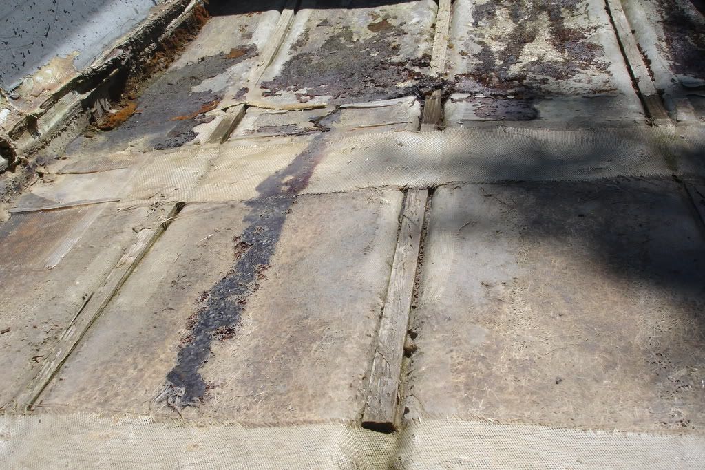

a quick questoin about the deck. this boat has ribs running down it like a aluminum jon boat. the boat came without a deck, in the front of the hull about where the bow begins to flatten out there are probaly 1 x 1 thin peices of would running down these ribs on the inside. assuming these are the stingers, shouldnt they run the lenght of the boat?? they stop about 20" from the front. im also assuming the deck sat directly on the bottom, these 1 x 1's wouldnt really hold the deck up off the bottom. so kinda confused on where to start with the deck. does it have to run the length of the boat, the deck i mean. i was planning on a raised, large casting deck front and back. also, being this boat is small and weight for me is an issue, does the deck have to be 3/4" ply. i know this is a lot of questions, but any insight would be great, thanks again for your help

her she is
as you can see i have some work on my hands. i cant tell if the deck was on the bottom of the boat. it looks like it has small stringers in the bow section. is it possible to add higher stringers to raise the deck a couple of inches. it would be great to add foam. a kind of flats skiff is what i want to achieve, with front a rear casting decks. anyways, any suggestions would be great.

Well, it's a flat bottom john style boat. Fiberglass type. Most of those are made from aluminum.
Shallow runner (draft) and your engine choice should be a short shaft. You have a 15" transom.
Looks like a salvageable hull. The front deck is cool.
Press on! I'd love something like that for river and shallow lake fishing. You can get in all kinds of nooks and crannies where the big one's sleep! It almost reminds me of an air boat hull.... something you'd see bombing around in the everglades.
no.....1/2 inch ext grade ply is just fine....glass it into the boat....hit search to find out how.......the glass will add stiffness as well as protect it from rot

i was thinking about raising the deck, putting in stringers so that i can put foam under the deck. hoping this would help with running shallow, or shallower. this may be off the normal restoration question but i do plan on raised casting decks in front and rear.
Adding foam won't change the boat's draft. Its purpose it to keep the boat from sinking if it gets swamped. The higher your deck is the more "tippy" the boat will become. If the boat is extremely stable now, chances are raising the deck will be ok. If you want to make sure, you can set up a little test with some plywood. Just make yourself a little makeshift deck and launch the boat. It's a good way to tell what your raised deck will feel like before you commit. Another way is to find someone with the same boat who has raised the deck and see what they have to say about it.
If you do build the deck, use materials as light weight as you can. You might even go as far as estimating the weight of these materials and put that much weight in the boat and see how it affects her.
