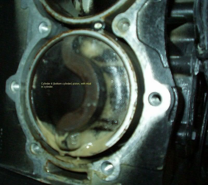

Once home, I pulled all the spark plugs, and checked compression: #1-120, #2-130, #3-130, #4-190. I couldn't figure out why Cylinder #4 was high, until I noticed that whenever I turned the motor over to check the other cylinders, that "mud" (actually, looks like the milky mixture of water and oil that I have seen from outboards with leaky lower units) would spray out of cylinder #4.

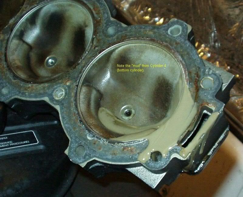

I wasn't too worried about a small amount of oil in the cylinder, since I tend to run my gas mixture rich (I have the automatic oil injector, but I also do a little pre-mix with the gas too). I figured I had either a leak in the head gasket or in the manifold exhaust gasket. I pulled the head, and the head gasket looks pretty good - there does not appear to be a source for a leak. But the cylinder head cover had this mud in the bottom area of Cylinder #4 (see picture).

The inside of Cylinder #4 looked okay, but when I turned the flywheel by hand, mud would come in from the side exhaust ports, into the cylinder. Looking at the below picture, the exhaust port is to the left (facing the picture).
http://i97.photobucket.com/albums/l207/sportjet/2Cylinder4PistonWithMud.jpg
Now under normal circumstances, I figure that the pressure from the cylinder detonation would exhaust the gas out, and water shouldn't be able to come in. Could this "mud" be entering the cylinder through the exhaust port with my compression checking, and also helping "seal" the cylinder (like injecting oil in the cylinder) resulting in the high compression number?

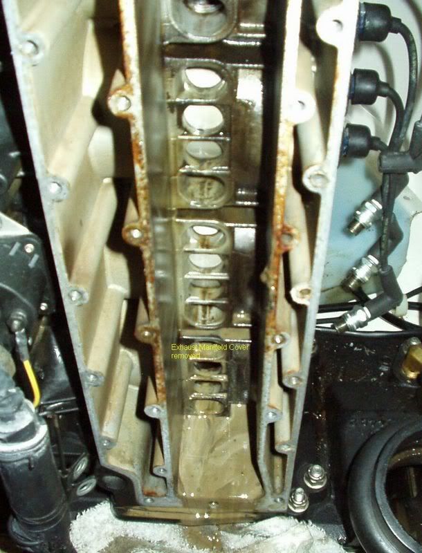

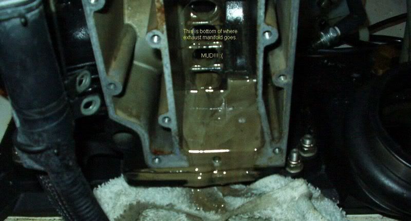

Anyways, I took the manifold cover assembly off, and found all this "mud" as show in the next 2 pictures.

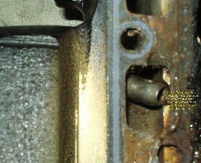

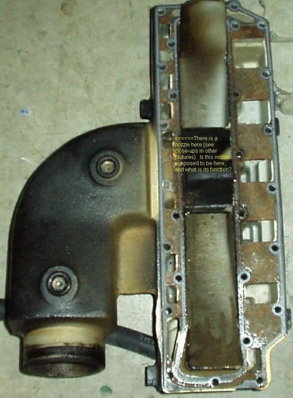

The manifold assembly cover gasket had a thinned out area medial to where I noted a "nozzle" (upper left area from writing in pictures). I thought this area could be a source of water leak. There was not much debris clogging up any water passageways (just maybe 2-3 small pieces of gravel).
But I was not sure what this nozzle did - did it shoot water in or suck water out? And if it shot water in, the direction of the nozzle would force a high pressure water stream right against the inner part of the gasket and could cause premature gasket failure there. I did run a thin wire down through the nozzle, but it seems to enter a space where it curls in the exhaust branch to the drive unit. Here are pictures of the "nozzle" - an overview of its location on the manifold assembly, and a close-up view of the nozzle which has holes on its sides in addition to being open on the end.

Anyways, I am not sure whether I should just replace the gaskets and give the motor a try (assuming the oil-water "mud" mixture is from water leaking from manifold assembly gasket, and the oil from running too rich), or whether I should just rebuild the motor (which I have never done before).
Also, I am puzzled about this "nozzle", so if anyone has any ideas or knows how it works, I would be very grateful for your help.
