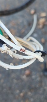

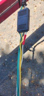

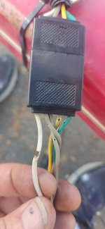

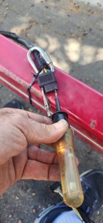

Problem Solved!! I had a bad ground wire, That makes sense because that can affect every circuit and all the lights on the trailer were out. It was a little strange: I have a circuit tester. It has an alligator clip for the ground and a pointed tip. If you touch anything with power the light comes on. See attached. I had good power and good ground going into the last connecter and I inch after the connector but still no lights.
I stripped the ground wire another 2 ft back where all the grounds come together and there was no ground!! To confirm that was the problem, I jumpered from that, bad ground to a know good ground and...All the lights came on.
Solution: splice in a new ground wire using a butt splice. Then I sealed the splice with liquid tape.
