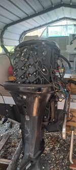

markf1962
Oct 2, 2017
4
Pics,maybe someone knows the model?
alldodge
Mar 8, 2009
42,561
Need to scan the motor for codes
Do have a manual showing 2.5/3.0 for 2002 and newer V6
Shows 2 places to look for +5V reference
