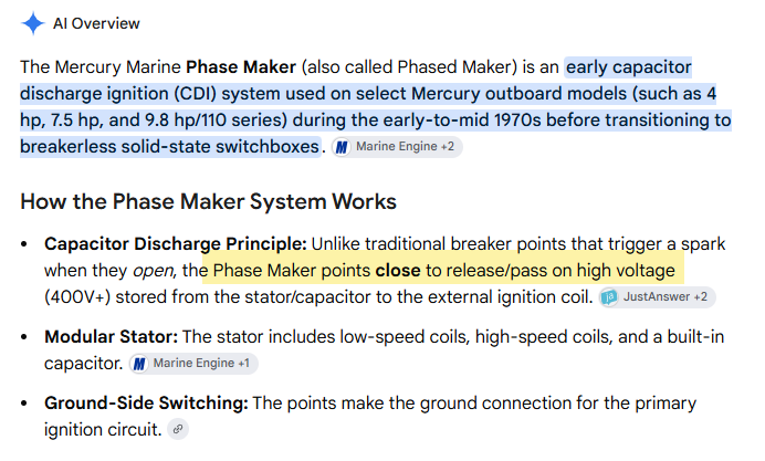

Mercury “Phase Maker” CDI system,
“capacitor discharge”…..had mechanical points.
points CLOSED to trigger the spark, as compared to other magneto systems,
where the points OPEN to trigger the spark.
Mercury gave this system the name: “Phase Maker Ignition”, because the points close (MAKE CONTACT…..i.e. “maker points”) instead of OPEN (BREAK CONTACT…..i.e. “breaker points”).
