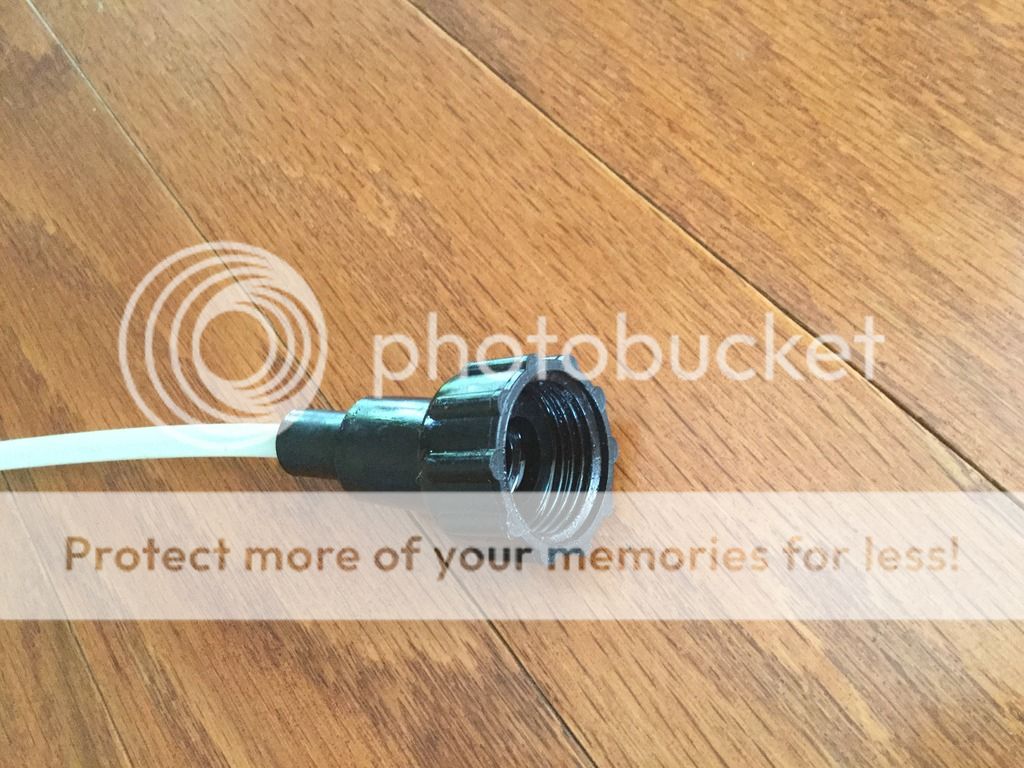

Does your disptick tube have the hose threads on the outside, like this:
If so, use that adapter rather then snaking an extraction tube down the dipstick tube. The suction will pull all the oil out. If this doesn't work, your pump has issues.

Agree with Spoilsofwar. The tubes you put down the dipstick are too thin. Your dipstick tube goes down to the drain plug so using the garden hose fitting at the top of the dipstick tube is the best way of doing it.

Yes I have those threads!! Are those a pipe thread? I don't have a adaptor that fits that.
bruceb58
Mar 5, 2006
30,581
Garden hose fitting. Buy a pump that comes with that fitting or make something that adapts to your pump. Have a link or picture to what pump you are using?

You'll need an adapter to use your pump if you want to use the disptick tube threads (and you should). It looks like this:
Personally, I greatly prefer the manual vacuum pumps to electric. I would get yourself one like this and stop messing around with an electric pump:
www.iboats.com/Seasense-Manual-Oil-...895223--session_id.457585603--view_id.1791237
But that said, there's no reason you can't use yours if you source the proper adapter.
