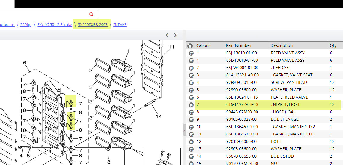

oil injection hose on starboard side had crack leaking oil
I should have known better but when I put a little force too remove and replace the tip of of fitting broke off into hose
Of coarse location is very bottom bit tight but i can get too it
Best way too remove , not plastic , seems like rusted aluminum
thanks

FOLLOW up - REMOVED , WAS METAL , PRESSED INTO BLOCK , MADE A DIY HAMMER PULLER AND IT CAME OUT . NOW I HAVE TOO TRY TOO FIND THESE OLD PARTS
