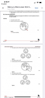

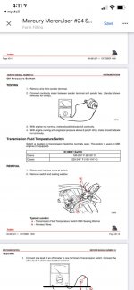

Thanks for the quick response! Ok I found the part that I need for the oil pressure switch to fuel pump. It’s only two wires and needs a plug to plug connection. Pic below of this part.
I unhooked wire on top as you described on the oil pressure sending unit and gauge is the same so I will now go and look for bare spot grounded in that wire. I will also test the unit and gauge if needed here is some other info I found.
Thanks again for clearing up which part was what......

I tested and ordered another gauge which was the issue.....all working now.
