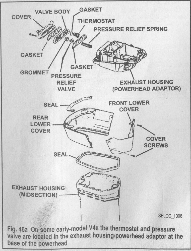

Another diagram:

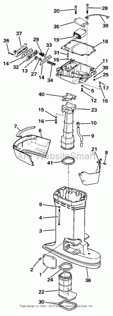

And another:

Another diagram:
And another:
