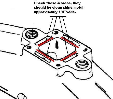

Don had posted in another thread this pic,
It gives you an idea what to look for..

As for how long? That's subjective. Pulling them for inspection, looking for signs of excessive flaking. The age of them. Any sign of the engine stumbling at idle. Inspection of the spark plugs... a super clean looking spark plug is a sure sign that water is getting in.
When a manifold goes, it may trickle water into the cylinders or it can let go totally, flooding the cylinder(s) causing a hydro-lock condition. You don't want that.
If you are to the point where you are thinking about them, it's probably time to consider replacement.
