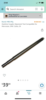

I couldn’t find the serial number on the outdrive above the vent hole.
It says alpha 1 though.
Would this be the alignment tool I need also
