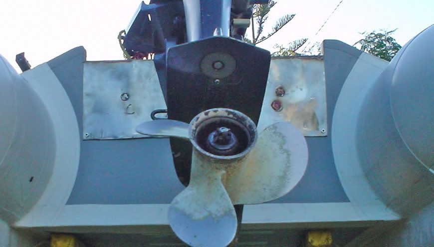

lol .... on my avatar is my new toy ... 8,5ft inflatable with customised highjackers and reinforced transom ... currently running with a highly modified 30hp .... get about 50mph out of it ... but still to slow ... waiting for my 70hp tiller mod motor ....... then i'll beat superman .... haha

LOL How the hell do you hold on to it. Btw is your motor bolted down? LOL this whole post is about my motor fallen in. ALso you got any pics of the reinfoced transom id like to see them d:)

how do I hold on? ... I use gloves ... lol my hands get blisters from holding on without them .... my motor is always bolted on with a safety cable for in case the transom comes off, I don't wanto loose my motor .... I found one pic of the transom with my old motor on, I'll try to take some new ones this weekend, as I am installing a transom extention on it for my new bigger motor, maybe i'll post pics on the project ..... what I did to reinforce this transom, I cut out the old one (20mm thick) and put a new 50mm aluminium one in and covered it in hypalon (dark grey), then on that I added a stainless steel plate that start at the back as you can see on the pick and wraps around to the front and then bolts on to the floorboard .....
