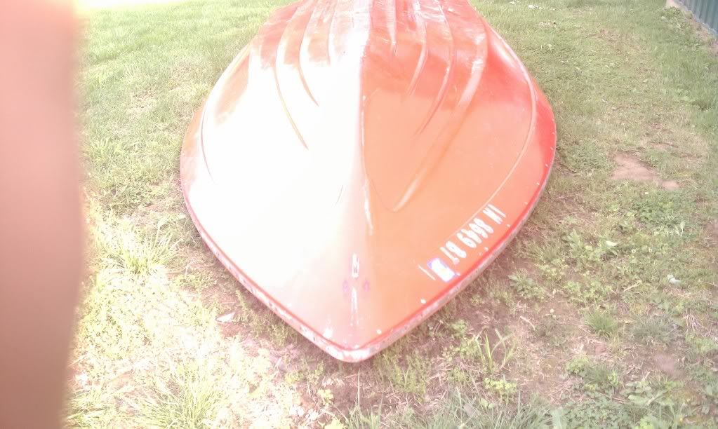

maagee79
Jun 14, 2010
174
Re: Paint????
this is my original post of the boat ( http://forums.iboats.com/showthread.php?t=477253&highlight=1976+checkmate ) and these r the pictures before i started sanding sorry dont have any more now. i hope to have it on the water by the 4th of july. bought a 1974 150 tower of power for it today and the vinyl guy called today and its done also so just need to paint now.
Woodonglass
Dec 29, 2009
25,929
Re: Paint????
Here's My recommendation. Sand her down with 180 grit. Use 3M Premium Filler to fill any gouges. (clean em with Acetone first) Prime With Rustoleum Oil Based Primer. The Paint with Rustoleum Professional High Gloss Oil Based Paint. Use this formula.
1 qt paint, 1/2 cup Acetone, 2oz of Valspar Acrylic Enamel Hardener.
Spray with a HVLP gun with a 1.8mm tip Or use a Foam Roller to roll it on and the Re-Roll it with a Roller with almost NO paint on it. Two coats and It'll look great. Tractor Supply Co. carries the Valspar Hardener, Lowe's and Home Depot carry the Rustoleum Paint. Two Quarts should be plenty. Harbor Freight Sells a HVLP gun for less than $50 bucks. You'll need a 60 gallon compressor to run it though.
