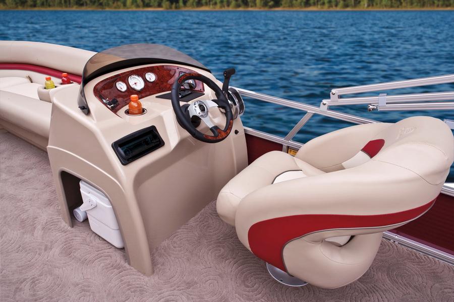

Here are a couple pictures from Suntracker linked below. The fish finder will be mounted using a Ram Mount above the throttle, below where the windshield stops. The VHF radio will most likely be mounted in the empty space between the steering wheel and gauge cluster on top of the console. I will be drilling some holes to feed these cable inside the console, where they can hook into the power distribution block, or otherwise be run to where they need to go. I will use something to keep them from chaffing. But I am wondering what to do to keep the holes cleaner looking, and to keep water from going under the console at those points. I have read where people use a clamshell vent, run the cables, then fill the vent opening with some type of sealant.
http://media.tmgcreative.com/2013/SUN-TRACKER_112013/Signature-Pontoons_2312013/PARTY-BARGE-20-DLX_3523/Features-Options_1327196/PARTY-BARGE-20-DLX_img22064_900.jpg
http://media.tmgcreative.com/2013/SUN-TRACKER_112013/Signature-Pontoons_2312013/PARTY-BARGE-20-DLX_3523/Features-Options_1327196/PARTY-BARGE-20-DLX_img22061_900.jpg
