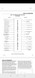

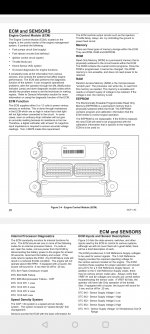

Dealer tried 4 times. 2 different laptops. 3 different Rinda cables.
Bypassed the lanyard and still no change.
Dealer isn't a PCM dealer. I would normally say look to Rinda, but being this is a PCM 555 (and not a Merc PCM 555) it doesn't look like Rinda had anything to read it.
Sorry to say, but I'm out of my league to help.
