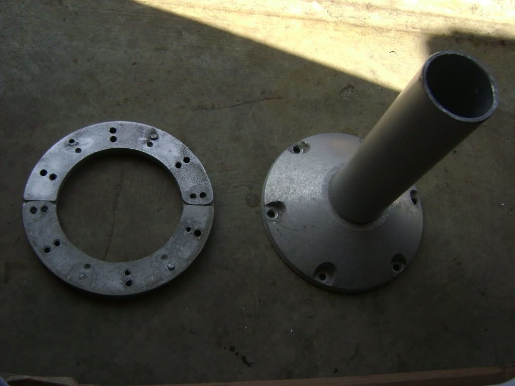

Deck rot is going to be the deciding factor whether or not you can use the pedestal seat mounts, even if you back up the mount on a rotted deck, it's most likely not going to last for long. If you can drill a test plug, and the deck plywood looks dry and clean you should be OK, wet, black and mulchy is not going to work.
It depends on how much room you have under the deck and on top of the flotation foam,,, and if you have enough room to snake a T-nut in there and epoxy it in place. Springfield has threaded mounting rings (backup rings) that I suppose you could cut in 1/2 and snake then under the deck,,,, if you have enough room under the deck. The bases I used require a 3 1/4" hole in the deck, so that should be plenty to work through, to get your below deck fasteners in place, though it won't be easy.
On my 01 Crestliner, they used a thick piece of aluminum for the backing plate, self tapping screws were driven through the deck and into the aluminum backing plate,,, and in a few places nuts and bolts were used with the backing plates
wewefirex2x
Feb 19, 2007
267
Re: Pedestal Seat Confusion?
This is what I was using until I had my deck replaced. A pedestal ring mounted under deck, pedestal srews to ring. The ring is two pieces. I have also had my pedestal powder coated aluminum since pic was taken...
