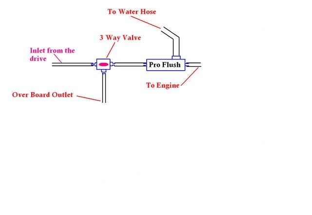

Re: PERKO Pro Flush & 2000 Alpha 1
The only way I can think of that the Pro Flush would work on your Alpha drive would be to install a 3 way valve between the drive and the Pro Flush. The purpose of the valve would be to redirect the water from the raw water impeller back over board and not through the engine while flushing. With the 3-way valve you really don't need the Pro Flush, only a hose adapter fitting in the same place you would install the Pro Flush.
What you're doing is much better than nothing but I like Realpoor's design withour the flushpro as you can really flush out while running it at op-temp. I was going to add such a system to my volvo but now run mostly on the fresh water Mullica river. If my engine were new, I'd be thinking of adding a closed cooling sytem.
