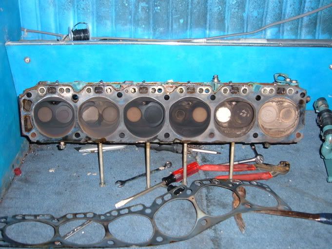

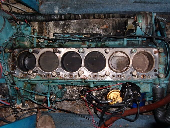

Referring to: http://www.iboats.com/cgi-bin/ubb/ultimatebb.cgi?ubb=get_topic;f=24;t=015087 <br /><br />Well, here they are... Not pretty!<br /><br />
<br /><br />
<br /><br />I thought I would find pools of emulsified oil sitting on top the pistons. The top of the head was covered. Rods covered...<br /><br />Now, time to get the head checked out...<br /><br />Also, time to pull the block, and get to work on some rewiring and clean up of the bilge!

I Can't see any water to oil intrusions in the pictures,......<br />It Does look like #2 was passing some water......(it well illustrates my Water Decarbonizing)<br />Do you see any Rust Tracks in the Manifold,..???....<br /><br />When you get the Block flipped upside down,...... Look along the Inside Portside Wall of the Block,......<br />If it's Freeze Damage,.... That's the most Likely Spot............

Intake had the emulsion in it. Exhaust was dry and black.

Well,.... You could have done a little more Testing before you pulled it down,.....<br /><br />Now,.. You've Got to Finish tearing it down to see Where it's Leaking........<br />Thou Pressure Testing is still possible,... It's a little more complicated now with the head off.....<br /><br />It could be the lighting in the pic. .. But I see #2 as being Awfully Clean,.....That means it's been passing Water........<br />Maybe it happened Late in the game,... Dunno.....

i keep hoping (for your sake) that the head gasket would be caputso, but it doesnt look like it is. And unfortunatly, that motor definatly had water run through it. <br /><br />still seems like a gasket problem though, seeings how select cylinders are clean. <br /><br />1,2,and 5 look like something isnt right.

Looks pretty typical of an inline 6.
