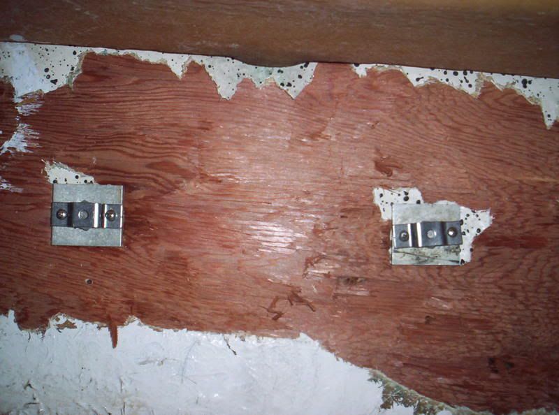

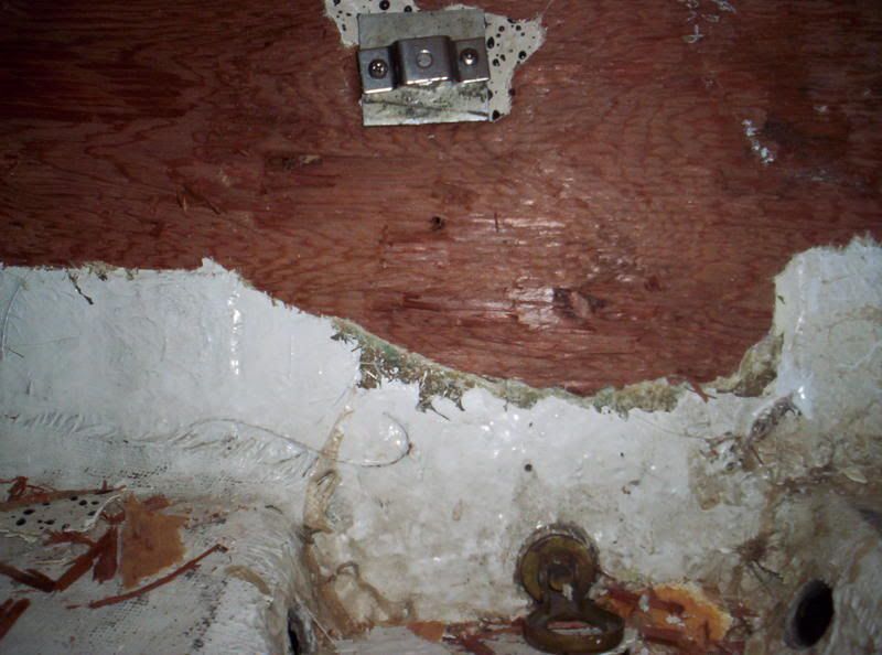

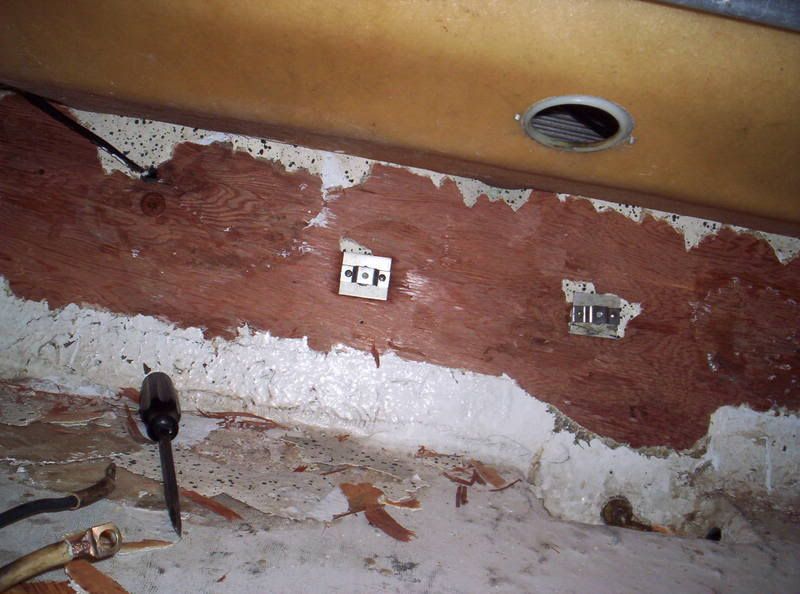

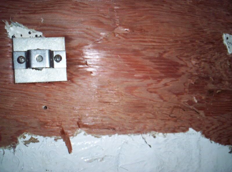

Quick background: boat is a 1968 SAFTMATE with 60HP that was added just a few months ago. Floor and stringer were replaced in 1997. I was aware that transom had been water soaked for at least 10 yrs (probably more).....
So, I stripped off some of the inner skin on the transom after drilling holes left questions about the wood's condition.
The wood is some type red colored wood. Suprisingly, it did not show obvious rotted areas (that I can tell), though the area between the bottom right motor mount bolt and the drain plug was particularly soft and wet. After applying heat to it for a few days, the wood has begun to harden back up....
My question is, does this wood look OK or is transom replacement in order?
Will the wood below the area I have exposed dry out as well if given time, or do I need to remove some of the deck and expose this portion of the transom first (theres about 3 inches of transom below the deck)??
See photos below....

The last photo shows the area between the lower mount bolt and the drain plug. This area was quite soft, but arfter drying it out, it has hardened up....Is this rotted or was it just soft from moisture??

Looks like the wood has delaminated from the fiberglass. Looks like one frame shows a crack in the transom ply? I've studied the effects of cracking plywood and the damage is usually much worse than it appears in the top ply.
My guess (worth nothing) is it's water saturated and expanding causing the delamination. It could probably be dried out COMPLETELY and re-glassed if not cracked.
OR
Looks like an excellent reason to sell the wife on an up-grade :)
The wood in the highly saturated areas is quite splintered. I dont notice any obvious cracking other than saturated areas that are splintered (from water saturation or rot??)
How are you able to tell that glass has delaminated from the wood??
It appears to me that water ingress source was around the drain plug sleeve (I replaced this past summer out of suspicion it was leaking into transom).

It does look like the glass peeled away from the wood a bit too easy... Though the wood doesn’t look (in the pictures at least) to be rotted. It is probably red due to some sort of treatment.

Thanks for the reply. So, if I dry it out, fill holes I drilled and reglass, it should be OK?

i wonder what the red is? could it be something thats was put on the wood, that was not compatable with the glass?

Probably some kind of preservative.
Splinters are OK, probably happened when you peeled off the glass. I'd dry it out real good, clean it with some acetone and unless there are real cracks re-glass and paint.
Good as new. I dont see any rot.
