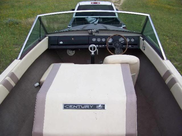

I will be constructing a new dash with recessed gages and have come down to a couple of options:
1) Make a mold and build a fiberglass layup
2) treat it as a woodworking project except use a plastic/composite boards
with my woodworking tools I am certian that I can do the option #2 and have this come out looking great. Can someone recommend some lightweight plastic that can be processed in the same manner as wood? What are some examples you have with using such material?
A picture of the dash I would like to construct is below. I appreciate your help.

jones01m
May 23, 2011
252
Re: plastic board construction - recommendations???
zopperman, thanks for the feedback. I like the dash that inspired you and the link you provided.
On the picture of the Century the panel comes to a line where two intersecting angles come together. The gages are recessed directly at this intersection. At the gage location there is a nice round over that could easily be formed with a 1/4 round on a router. The intersecting angles could also be formed fairly readily with a tablesaw. I am confident I can make this out of wood and have it look very nice, however, I would want to completely seal it off and paint it or gel coat it. I am concerned about wrapping glass into the gage recess and have it come out correctly around the sharp transtion - so there goes making it with wood and resin an glass coat.
The ideal would be to make out of a paintable or gelcoatable (probably not a word??) plastic, and just use the same cutting processes a would as working with a wood project.
Again, I really appreciate the suggestions.

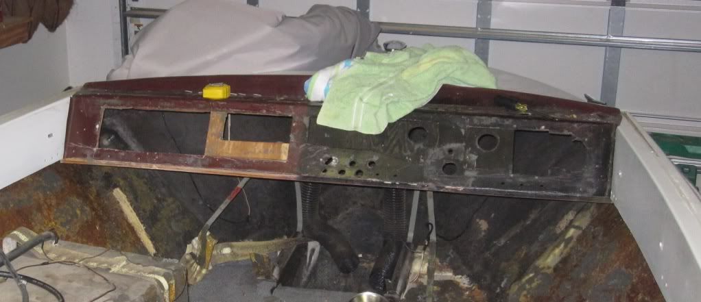

jones01m
May 23, 2011
252
OK. I am convinced. I am going with MDO. It will be a while but I like to try outline my approach prior to actually getting to the task. As you can see from the photo below a have a ways to go.
