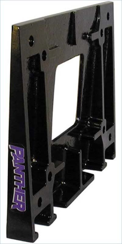

I have one thats made for the larger outboards.Its reversible so you can make it give you more trim in or out.My boat did not need it so i took it back off.
Its powder coated metal so it will never rust or corrode.It was over 150 bucks!...I think it helps spread the stress on the transom out some too.
http://www.marineengine.com/products/accessory.php?in=1940420
If anyone needs one just PM me...
