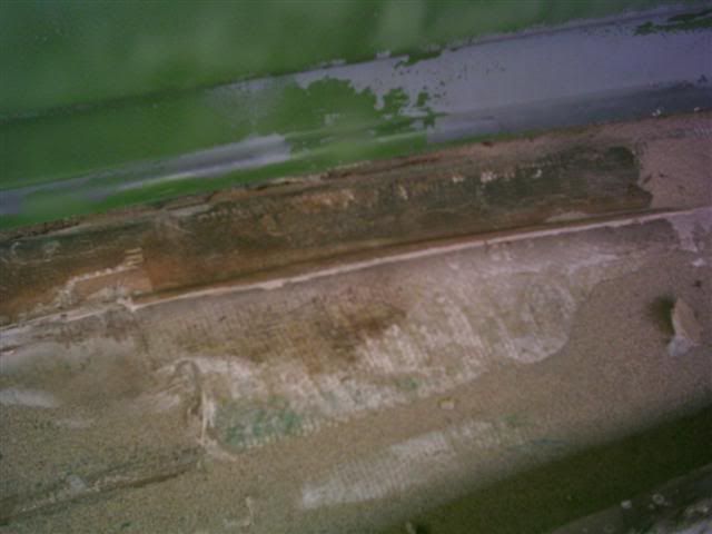

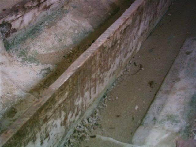

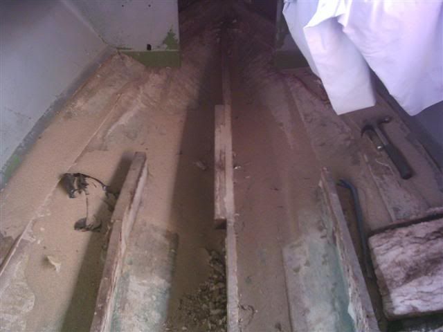

I'm neck deep in a boat resto now myself, so I'd like to get my head around this. When I pulled the floor up in my boat, the false bottom was completely filled with water. There were some obvious reasons for this, that I won't go into here. There was "some" poured-in foam in the bottom, rather haphazardly poured in there, allowing water to get in around it. After I put mycompletely glassed floor back in, my plan is to pour in enough polyurethane foam to completely take up all voids under the floor. My question is, if you properly glass and seal the floor, how can water get in there at all??? And if the false bottom has absolutely no voids, even if there is a perforation of some type, how can water get in? I doubt in my boat water will ever get in the false bottom, since boating season around here is very short, and my boat will be 100% garaged when not in use.
