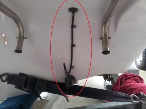

I purchased a used boat recently and one of the things that needs attention this off-season is re-sealing the hole where the speedo tube passes through the transom. The prior owner added a transducer to the transom and ran the transducer cable through the same hole in the transom with the speedo tube. Both the speedo and the depth finder seem to be working ok but I have never seen the cables strung through the transom this way. Since I have to re-seal the hole in the transom because the PO used silicone instead of much better options commonly available, am I fine to leave both cables in the same hole (assuming they are not pinched when I get in there) or is this bad business and I should separate the transducer cable into its own dedicated passageway?
I would rather not drill any more holes in the transom, but if I am just inviting trouble the way it is currently setup, then I will just have to drill.
Thoughts?

Dog-gone-it! I took the line out about putting the hole above the waterline. I've seen some where they hold the speedo tube with those clips that screw...right into the back of the transom.

Rickmerrill - what kind of clips are you referring to? My boat has a pitot tube shield that turns the tube down and protects it from impacts on the bend, but I don't think there is any sealing action from this...?

Sorry for the confusion, don't know what they are called but the three little clips holding the speedo tube straight.
If your going to have some gelcoat work done anyway this might be a good time to plug up that old hole and put a new one up higher. There's a reason some people are Supreme Mariners and others are CPOs yah know...
