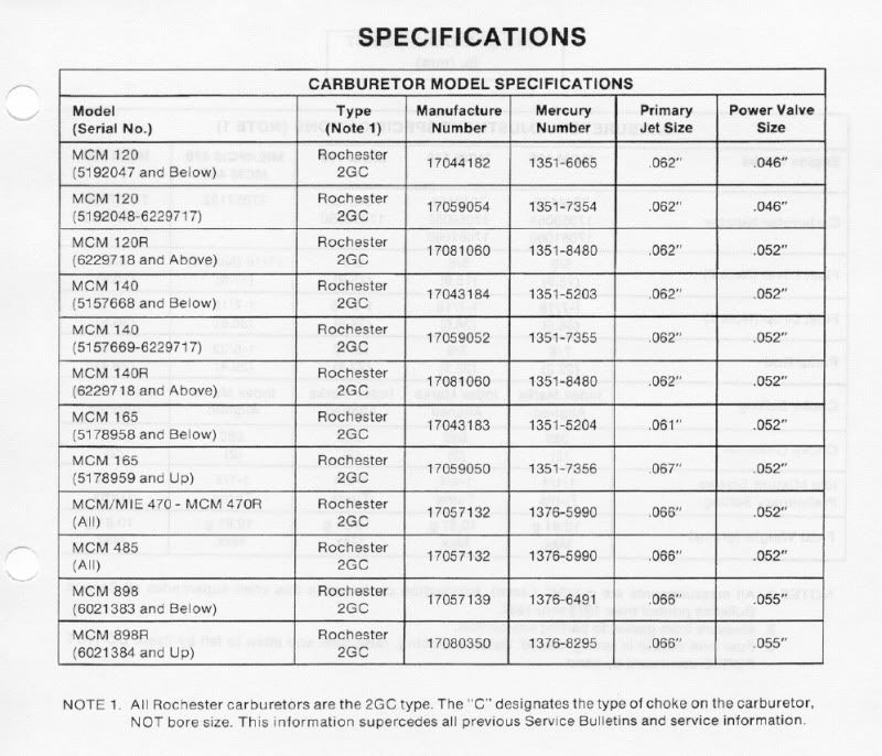

45Auto
May 31, 2002
2,842
Re: Possible 3.0 Carb issue.
1984 Mercruiser carb specs. Yours would originally have had an electric choke Rochester 17043184 or 17059052 depending on your engine's serial number:
Reming870
Jul 15, 2010
191
This is perfect. Thanks 45Auto!!!

Reming870
Jul 15, 2010
191
OK Got some better data now.
Engine ser# is 6829350
Current Carb is 13898490
New Roch Carb in box is 7041139 05711R1
So it appears the previous owner brought the Rochester based on the carb thats on the engine.
It also appears that the carb on the engine is wrong.
So, I have two carbs that won't work???
Can someone confirm if the new Rochester I have will work?
