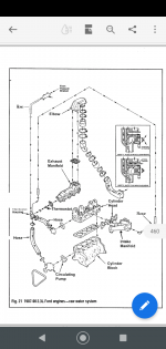

1. Remove the hose at the thermostat housing which comes from the impeller pump. Connect pressure tester here (hopefully I have an adapter, if anyone has advice on what I'll need to make this connection, spare hose maybe?)
2. Disconnect hose at thermostat that comes from intake manifold and plug (with one of my tapered rubber 3/4" to 1" plugs)
3. Pump 15 (or 20?) PSI into the system and monitor for an hour.
Sound about right? I spent about 45 minutes studying the diagram to come up with step one and two 😆but I think that's all I need to create a closed loop, the air will go from the thermostat, through the circulating pump, to the block to the head from the head it will go out two directions, one back to thermostat, other to the intake manifold, then from the intake manifold it wants to go

Forgot here's a diagram of the cooling system on this engine and the plugs I got
