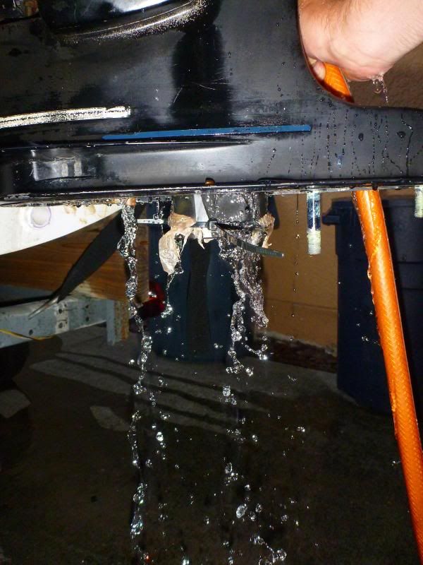

In these pictures, you can see water and burnt oil/gas mixture escaping between the lower unit and the mid section. I believe this is another symptom of my overheating issue.
So the water/goo mixture seems to puddling up in the midsection and NOT exiting through the exhaust/propeller. It is being forced out as you can see. At first I thought there was an exhaust leak where the exhaust tube enters the lower unit. However, if this was true, something would have to be blocking the drainage in the lower unit, and causing it to go up. There is no such blockage and when the motor was together, it seemed like very little exhaust water coming from the propeller.

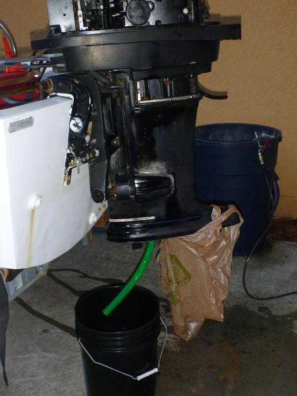

Here you can see I have the water tube exiting into a bucket, and the exhaust tube exiting into a plastic bag. As far as I know, these should be the only two exit points for water if I back flush through the tell tale.
When I backflushed with water through the tell tale, a steady stream came out the water tube but almost nothing through the exhaust. However, a lot of water came through from somewhere higher up in the midsection.
So I am assuming whatever seals the power head to whatever it's attached to is leaking. Looking at the link below, I found a powerhead gasket( #8). Could it be this? What do you guys think?
