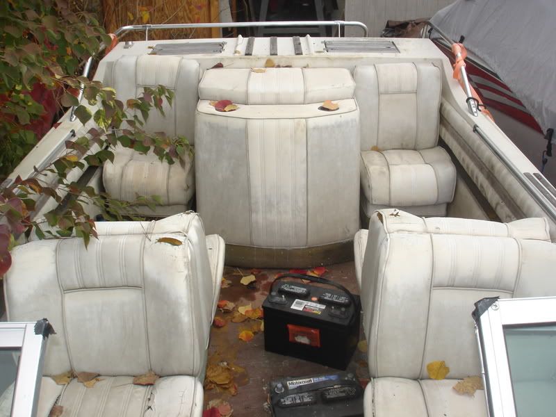

Interior is stock, 25 year old cracked vinyl. Floor has a few soft spots.
