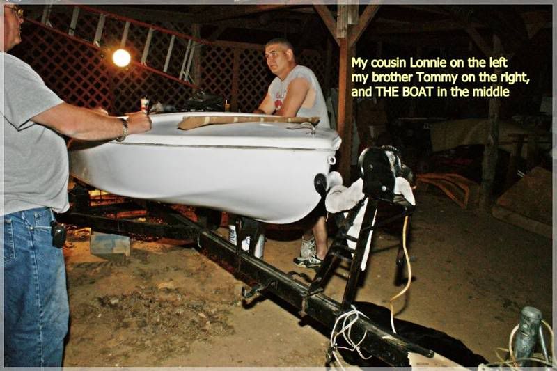

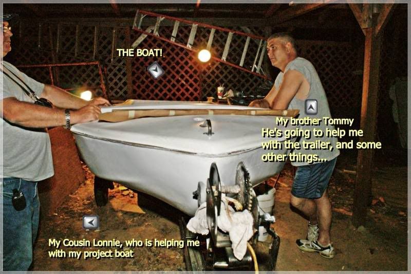

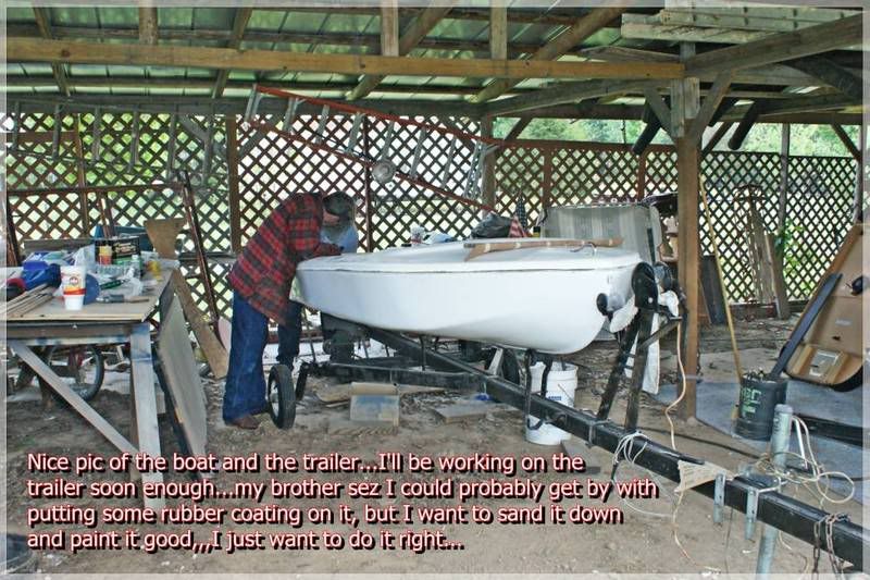

My cousin, Lonnie, who works for UPS repairing their trucks and equipment, and who is a whiz with fiberglass, is having a blast working with me on this little project boat, and it's giving me an awesome opportunity to see first hand just how you go about working with fiberglass. My brother, Tommy, to the right in the above pic, will be helping me in refurbishing the trailer.
This pic above shows a better angle on the bow and underside of the boat, and the trailer it is sitting on.

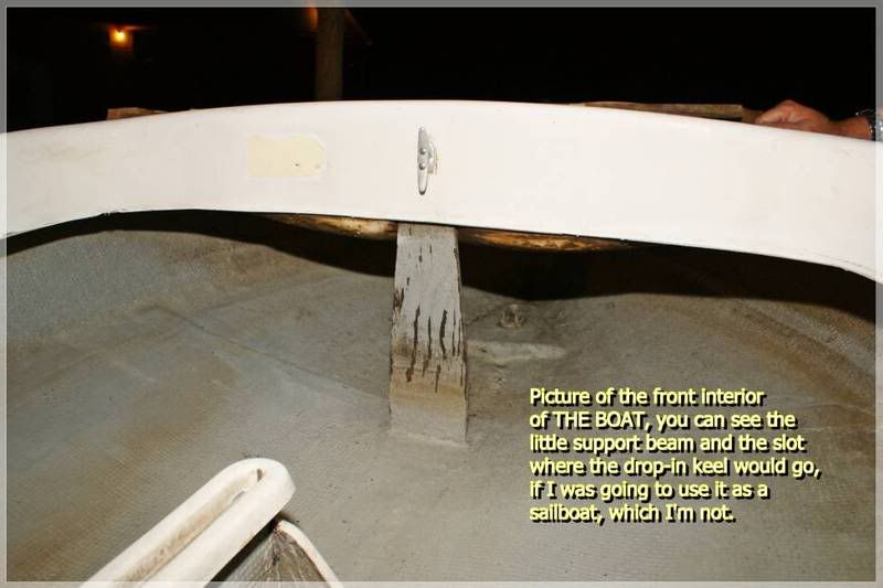

Above pic shows an interior shot of the boat towards the stern.
This pic above is an interior shot from the stern looking towards the bow.

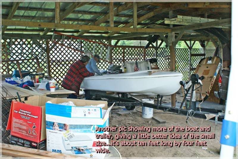

Another pic stern to bow showing a bit more of the boat.

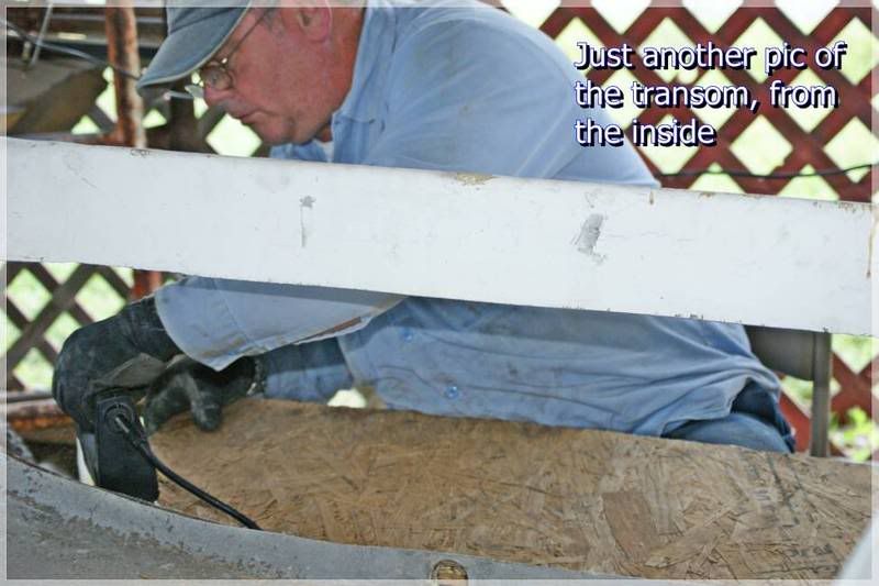

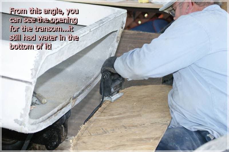

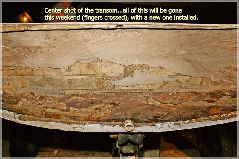

This is a pic of the transom...before Lonnie had found out about my little puddlejumper project boat :)D), I had already glassed in the left corner of the transom area, NOT KNOWING that the wood underneath was bad. It felt solid to the touch, but when he came over, he wanted to check to be sure, and I said go for it.
Lesson learned...NEVER ASSUME! lolol!

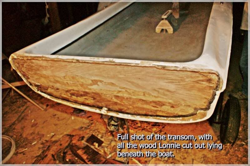

He cut a small opening in the other side from where I had been working, then looked at me and said that my glass job was fine (not bad for a first time, hehehe), but whoever had done the PREVIOUS glasswork was either plain out sloppy or they were cutting corners. Apparently, instead of putting in a new transom, they slapped in some thin sheets of luan (spelling? lol!) and then slapped on some thin fiberglass over that. Because the boat hull is formed all around, including across the top of the transom area, which is still strong and very firm, it hid the weakened and rotted out condition of the underlying wood.
I told him to rip it all out and let's do it right. He asked if I was sure, since I had already patched the one area on the left, and I said dang skippy, cuz I wanted to do it right, so he proceeded to go ahead and completely remove the bad wood and fiberglass overlay.
If you look in the above pic, you can see the worst of it laying on the ground beneath the boat. Once he removed that outside layer of rotted wood and glass, he then cut out the rest of it.

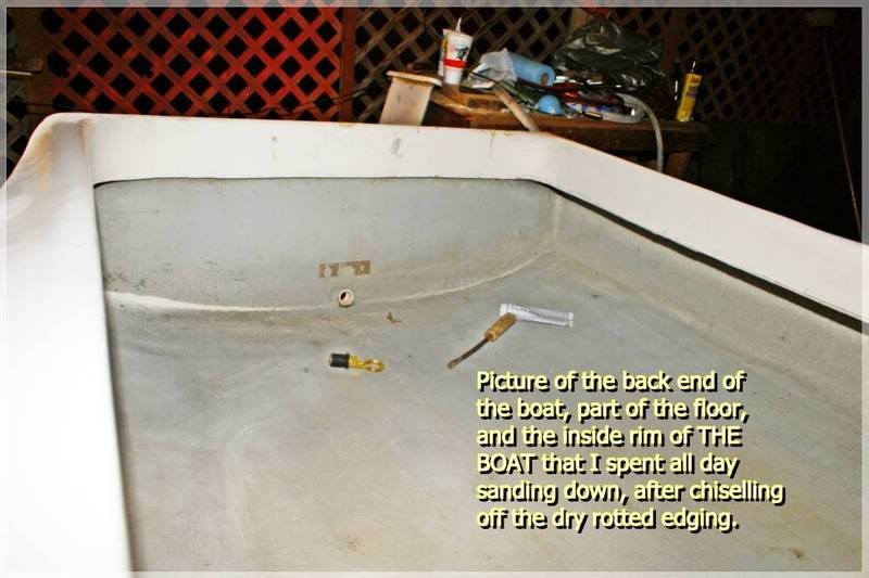

I had already done a huge chunk of work on it, as it seems someone along the way must have thought tub caulking was a good thing to use to seal the seams??? Sand sand sand, cut cut cut, and more sand cut sand cut, all day, as I labored at getting that gooey, rubbery crap out of the seam and off the edges of the seam. I then went to work on the inside edges, where the edging was cracked and also crappy. Good thing I have long thumbnails, it was the only thing that seemed to work in some areas to pop and scrape the mess off!

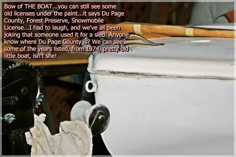

You can't see it very well in the above pic, but on the hull are several old stickers, dating back to 1974 and above. The boat was at some point registered in Du Page county, Forest Preserve, and I found when I googled it that this county was in Illinois. I have no other info on the boat, when I bought it, the guy didn't have a title, just a bill of sale that he gave me, so I think I'm in for a rough time in getting it registered when we get done. Ah, well, that is a headache for another day!

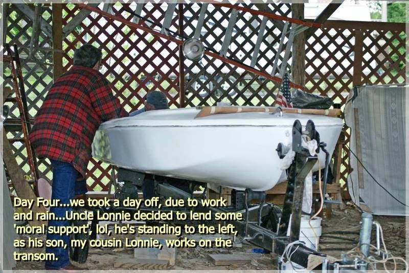

We took the next day off, due to work and weather, then Lonnie worked some more on the transom yesterday.

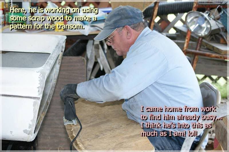

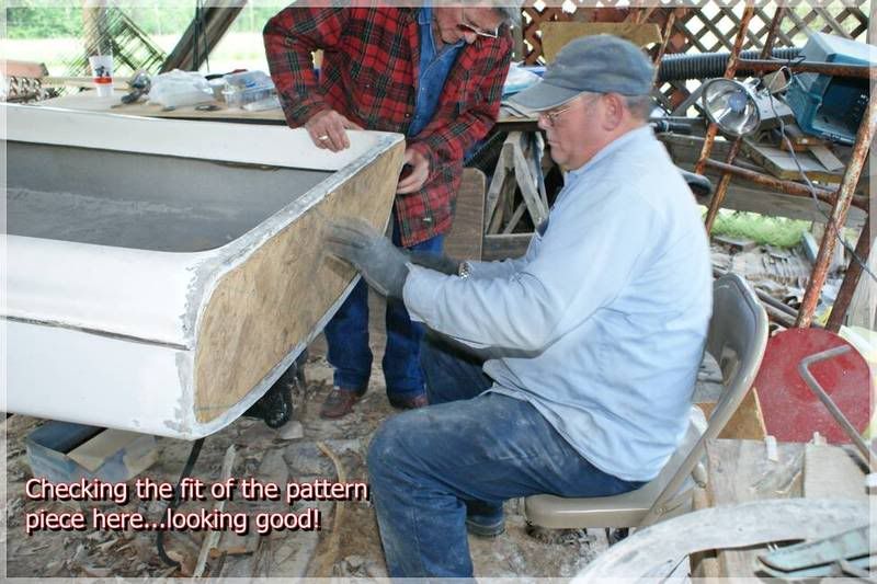

Lonnie worked on the transom yesterday, making the pattern...I went to Lowe's and got some 15/32 two foot by four foot for the actual transom wood, and after he cut it using the rough pattern from the scrap wood, he then glassed it. The following pics show him making the pattern, and give a better idea of the size of the boat, too...I'm going to take some more pics in the morning, showing what he did today, as he now has it glassed into place, and will be adding more.

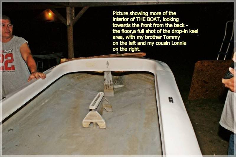

In the first set of pics, you could see the drop through for the keel. He has already cut that out for me, has cut down the keel, and will be putting it into the drop through and glassing it on both sides, for strength. What I'm knocking around in my head is this...I'm wondering if it might not be a bad idea to see about adding some sort of runners down each side, sort of creating a tri-hull for it, to help compensate for the loss of the keel.
Since it was designed as a small sailboat, the keel was an important component for stabilization. But using it as I am planning to, I'll be going into some shallow areas, and it was just impractical to keep it.
