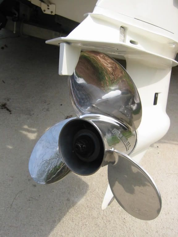

i have a 13.75" 15 prop on a '95 88SPL pushing a 17' CC.
i have a line on an SS 14" 19 prop...
will the 14" prop fhysically fit? yes.
however, at what point is the clearance between the tip of the prop and the cav plate too close.
is there any drawback at all as long as blade doesnt make contact?
thx.

There's < 1/8" clearance on my E-Tec when fitted with my BRP Rebel prop.

Jeesh..! lol...ok so i've got no worries on clearance apparantly. hahha.

The Rebel has the surface area that a similar 4 blade does. The blades are huge and 15 3/4" diameter.
Mine is a 15" pitch.
It's on an 1850 Seaswirl.
It would be my favorite prop if it wasn't so expensive...it gets the best mpg (5+) and the control is outstanding (including reverse). We do a lot of shallow water exploring and I tear up props regularly so I don't use the Rebel anymore.
