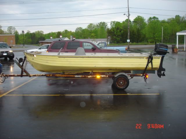

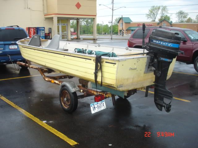

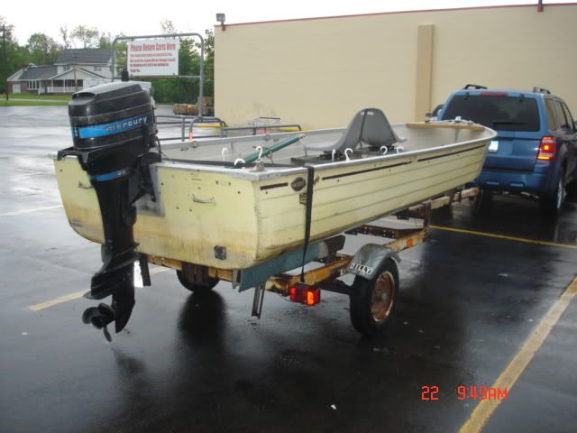

Here's a few pics.
BTW, the hole I am speaking about is just above the casting over the prop.
It's not the water pee hole that indicates cooling water flow.
