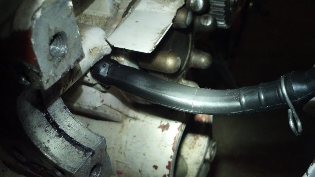

Ive done this once or twice before with success, but this time I cant get the cable to push through without bunching up at the last few inches. Ive tried my usual tricks of water based lube and/or soapy water and nothing is working. The hole in the intermediate is clean. Does anyone have any advice?

Do you have someone pulling on the inside? I just had to pull my cable thru several ports in the outdrive. I used plain old grease to do it. I just slathered the grease on and rubbed it around with my fingers. I now have to install the drive and do what you are doing. I expect no less success.
One thing I notice is that there appears to be a bulge in the cable as it is entering the passageway in the intermediate housing. As your cable is for a full mechanical drive and mine is for a hydro-mechanical drive, there may be a difference. Not sure on that. But I do know your cable looks too dry.
Plain old grease (marine type) is good because it will cut down on any corrosion inside that passageway.

Mine is a hydro as well. That bulge is the outer rubber sleeve bunching up as I try to pull it through. That's my problem. Always heard greese was bad on these rubber cables because it corroded the rubber but if that's my only course of action I'll try it. Oh and no help either. Pushing a little and then pulling...

Well Boom, grease did the trick. I can't thank you enough for stopping by. I'd buy you a beer ifyou were near me. I guess well just have to see if the grease hurts the cable over time. I only used a thin coating. Man, i was ready to throw in the towel...or set the boat on fire. Lol.
