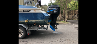

Hi folks, I need to check the viability of raising my outboard about 6" higher (By simply removing and remounting from top to bottom bolts on transom bracket)
I want to do this so I can get the trim rams out of the water as this boat is on a mooring all of the time.
Hopefully there is enough in the picture attached. What should I be considering when raising the motor up a bit. You can see the resting waterline where the colour changes (antifoul)
The water intake will be still well underwater, is there anything else I should think about ?
I assume it's just fours nuts, pull it off and raise it and nuts back on again. Unless you think I need a plate in between ?

buy a jack plate. that way you can raise it for mooring and then lower it to use it.
if you raised the motor 6", you would never get on plane, and even though the pickup ports are below the water, the water pump wouldnt be and it would never prime and you would toast your impeller the first time you ran it.

WOW, that is a lot of raising. If you don't set it back from the transom, like Scott stated above, you will burn up the engine in short order just raising it 6". But when you set the engine back from the transom (via a jack-plate), the water gets angled into the water ports. Usually the set back should be equal to the raise in height. But whatever you do, make absolutely certain your water pump is working properly when on a plane. It is that important...

Simply tilt the motor fully up, the lower leg should not be in contact with the water level...

as you raise the motor and the anti-vent plate comes above the bottom of the hull, you will eventually ventilate as you apply throttle. from what I see, your motor height is perfect.

Just raise the motor 5"-----Then install a 5" extension kit to put the lower unit in the right place.-----
