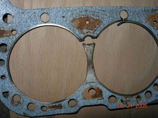

I just replaced the head gaskets on my 5.7. I burned a gasket for as yet, an undetermined reason (see the picture at the end of this posting). I asked many for ideas why this might happen and one veteran speed shop guy said he had seen this happen due to a crack (not visible) in a head bolt later discovered on reassembly. In the interest of making sure I didnt have the problem again, I bought a new set of head bolts along with the new gasket as well as a new torques wrench. When I installed the heads I couldnt get one bolt to make the torque wrench to "click" over set at 65 ft lbs. I finally retorques all the other bolts (on that head) and when I loosened that bolt and retorqued it just snapped off. I was just wondering if anyone else has ahd head bolts crack and cause gaskets to blow ot if they had new ones break off??<br /><br />By the way all is well though it cost me a couple of extra hours, I pulled the head again and was able to tap out the bolt with a screw driver and reset the head and use an old bolt (from the other head that didnt burn the gasket just in case!!). I will try to start her up later today.

Vatter, where on the gasket did it fail? or 'burn' as you said?...sl

Thanks for the postings guys. Ben gone boating for a whole day!!! From Sat night to Sunday night. Longest boat ride of the year!! The boat ran the beat it has since the rebuild. I still have a hesitation when I go to WOT from a standing start but I think I need to reset the rear choke plate hold off on my Qjet. I think I messed with it trying to get the bog out. But if I took off a 3/4 throttle and the open it after on plane I was getting to 4600 Rpm no problem again!!<br /><br />On the bolts, I bought the new set from a high performance auto engine rebuilder locally. They were the regular style not torque to yeild. I have no idea what the rebuilder put in though. They are an auto and marine rebuilder and I think they do more autos so who knows.<br /><br />On the gasket Steve, it burned from #6 to the bolt in the space between #6 and #8 and also from #8 to the same bolt creating a 3/8" wide burn path from #6 to #8 through the bolt. Since it went this way, no oil passages or water passages were bridged to so the engine ran (poorly) but no water in the oil or excessive smoke fron oil consumption.

For any one interested to see where the head gasket burned I took a picture of it just before putting it in the trash. Also, I have never posted a pic so I am using this as an excuse to try it out!!!!<br /><br />

huh where's the rest of the steel sealing ring? I hope you had it to!<br />Ottawa

Next time you need head bolts get ARP bolts. Automotive Racing Products has the finest bolts out there for a small block chevy. If you break one of these you brag about it. The head gasket looks like it had been blown for a long time.

ottawa, yes, the whole sealing ring was there except at the burn. I actually pulled them off trying the magnet thing to see if they were stainless, they were.
