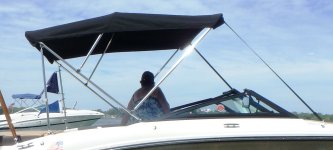

Just my opinion, so don't take offense. At my age I have had some sun related problems, so I put a bimini on my 14' utility fishing boat. I just could not sit out in the sun all day on a fishing trip.
It was unmanageable. It got in the way for everything. Besides, when on plane it acted like a sail and screwed up my stability. I ended up leaving it down, so basically that eliminated any advantage.
I ended up selling the boat and buying a bigger boat that had a factory bimini in the first place. Obviously, a big expense on my part, but now I can fish in comfort.
Regardless, if you are set on one, to answer your question it should be located so that it shades any and all seats you intend to sit on. Also, it needs to have any straps or rods forward of your rod holders so you can still pull up a rod without it being constrained.

All biminis have a center fixed mount for the rods, with a second detachable mount for one end (either fore or aft). The opposite end is attached with an adjustable strap. It has to be that way or there would be no way to adjust tightness of the assembly.

Not all biminies have that strap. Mine is rigidly braced forward, with a braced bar forward and aft holding the top taught. No deck obstruction.

Obviously, a PO removed the strap and added a bracing bar in its place. As a matter of fact, I did that very thing eons ago on an old boat when the strap needed to be replaced. Poor choice on my part because the fixed mount would not allow tightening when needed.
Furthermore, my new bar was MORE of a deck restriction than the strap....
