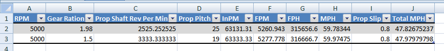

This morning I built a Excel spread sheet where I can enter RPM,Prop Pitch, Gear Ratio, and slip and it will give me MPH.
This is what I got. So is it better to run a 19p faster to achieve the same MPH as running a 25p slower? I will leave my thoughts for now.

Ayuh,.... Generally speakin' the range of standard pitch props runs from 15" to 23",....
You have to swap the gear ratio, so the motor will achieve it's designed Wot, usin' the pitches available,...
I can tell ya right now, you Can't buy a prop Small enough to run a 1.50:1 on a 3.0l motor,....
'n ya Can't buy a prop Big enough to run a 1.98:1 on a V8,...
Been there, tried that,...
