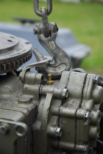

Here's mine. I just used rubber hose from an auto parts store. The motor is a '72 Johnson 65hp.
The nipple is a stock OMC/BRP carburetor part. I tapped into the head after consultation with my local OMC/BRP dealer. This was done because the only good place to put one in the powerhead water jacket, is behind the ignition component bracket. Putting the nipple there would make replacing the hose a major hassle.
I also offset my nipple in the top of the head, so that it would not interfere with the lifting point.
a70eliminator
Sep 9, 2007
3,762
Re: Question & pics of homemade tell tale
Nice, boy oh boy what a difference a few years can make, 72 looks alot busier than they did in 67. (another great illustration for the file)
